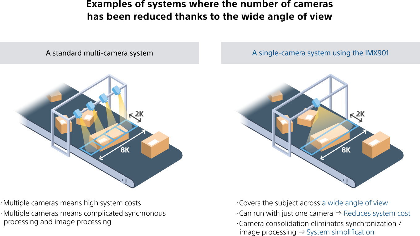

In today's logistics systems, where belt conveyors are seeing wider belt widths and faster speeds, there is a growing demand for image sensors that can expand the imaging area for barcode reading and improve imaging performance and efficiency. Typically, multiple cameras are required to capture the entire belt conveyor in the field of view, which can lead to concerns about increased camera system size and costs.
A single camera equipped with the new sensor announced today can capture a wide-range area horizontally, helping to reduce the number of cameras and associated cost required compared to conventional methods. In addition, leveraging SSS's original back-illuminated structure, Pregius S, the new product delivers both distortion-free high-speed imaging and high image quality. The product also features a wide dynamic range exceeding 70 dB and clearly captures fast-moving objects with a high frame rate of 134 fps.*2
This product, which can capture images in wide aspect ratio with high image quality and high speed, can be used for barcode reading on belt conveyors at logistics facilities, machine vision inspections and appearance inspections to detect fine defects and scratches, and other applications.
